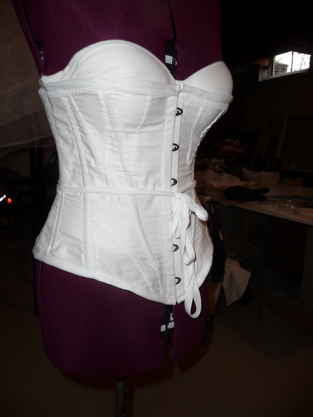

If it helps, this is my corset:
It's made from Kay Gnagey's pattern, which I'm very happy with.
If you are not 'fluffy' don't worry too much about making petticoats before corsets!  My measurements don't change in a corset, and I am not bony but not fat either.

Beth!  Thanks for all of the encouragement!  I've never worked with boning before (well, besides cheap zip ties), so the whole thing is a new experience for me - I'm a terrible perfectionist, too, my Achilles heel Wink  But, no more!  Your reassurance and very successful(!) result has put me at ease and ready to tackle it.
(Ha, "homegrown" coutil)  Okay, I'm looking for no stretch, got it.  (Huh, learn something new everyday!)  And busks from corsetmaking.com are a go.  Ooh, by the way, I love your corset too!
