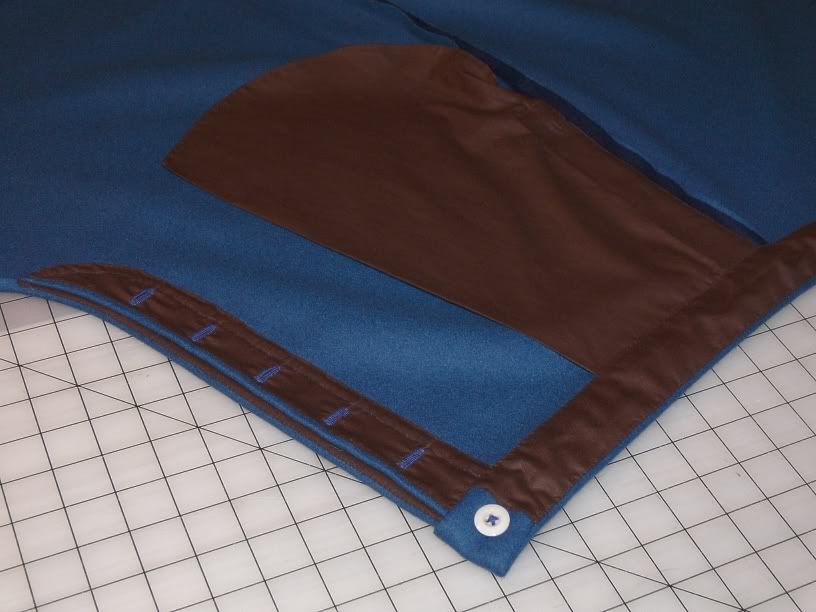

This week I started construction on a pair of Federal infantry officer's trousers.  These were cut like civilian models so there is much here that may be of general interest.  Here is progress to date.

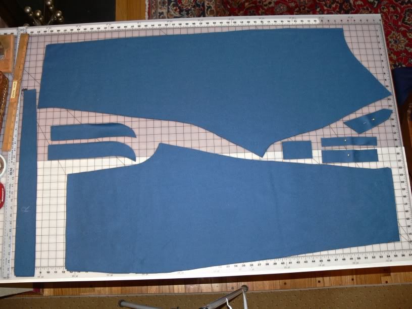

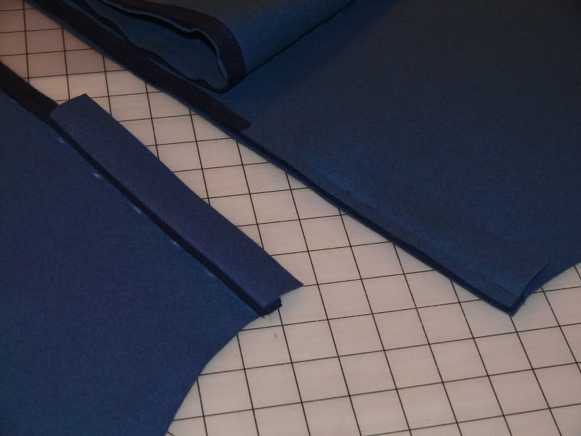

The first picture shows the layout of the wool pieces.  The material is a Hainsworth light blue cloth, a bit heavier and not as fine as their broadcloths.  It's about the same weight as County Cloth's light blue "kersey" but is a much richer blue color.  The draft is to the client's measures from DeVere's.  In addition to the fronts and backs, you can see waistbands, fly pieces, pocket facings and back tabs.

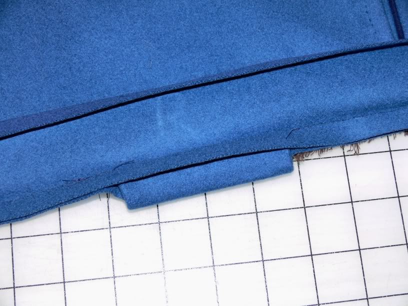

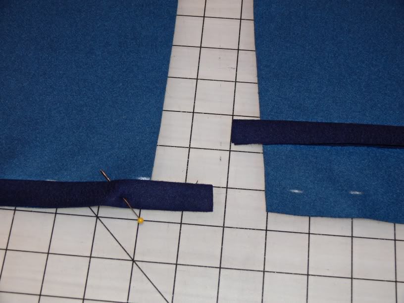

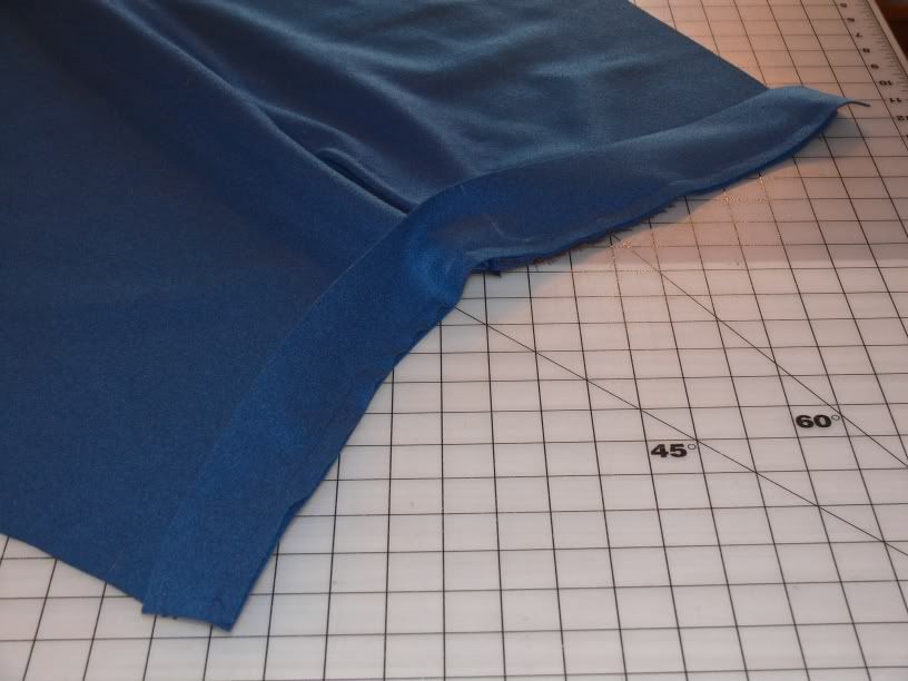

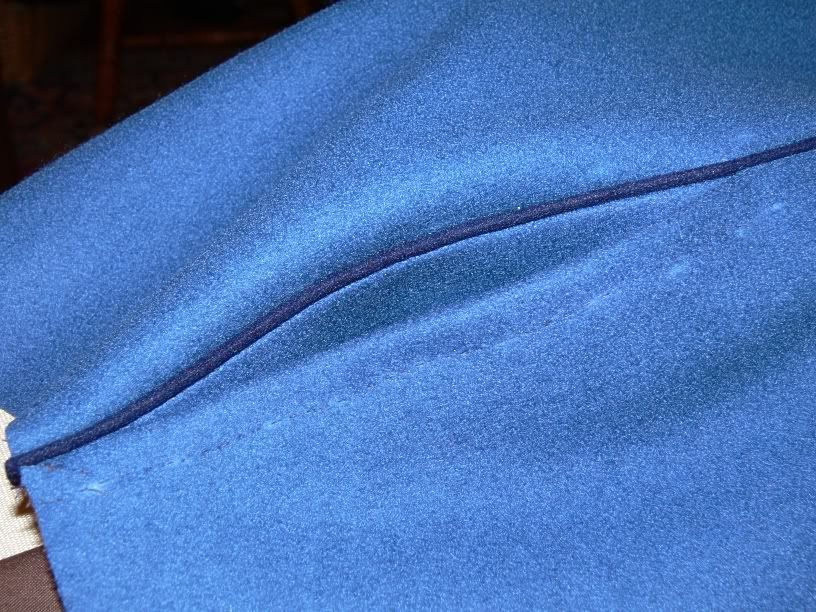

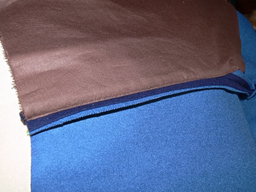

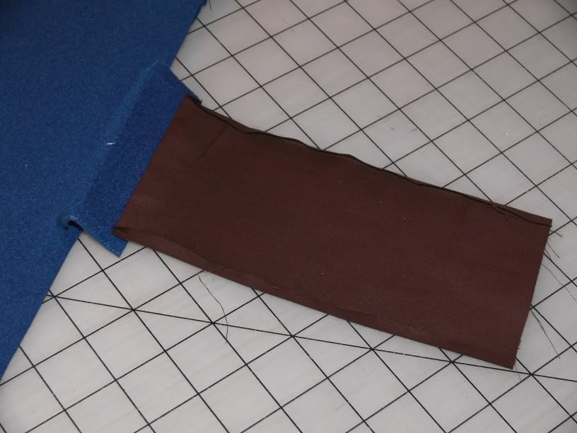

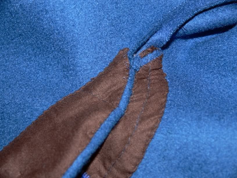

The second picture shows the officer's dark blue welt going on.  A piece of dark blue broadcloth is doubled over and basted to the trouser back.

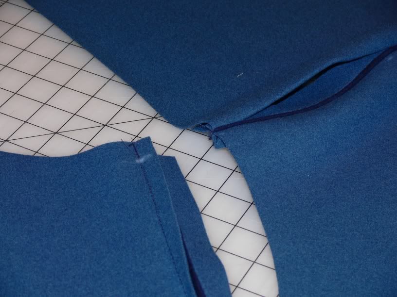

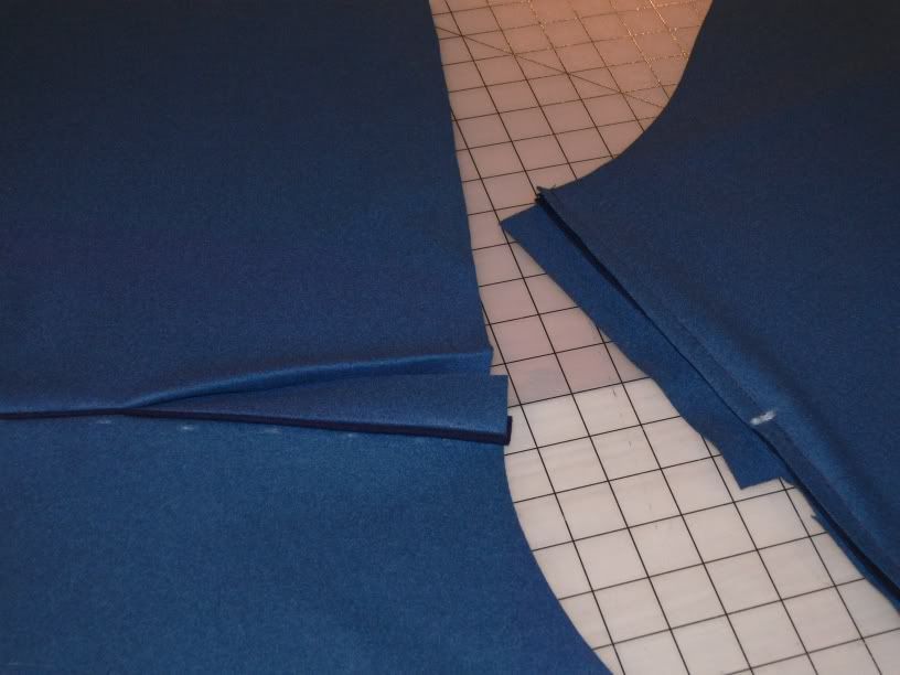

Next, the inner pocket facings are sewn to the backs, and the seam pressed open (exposing the welt):

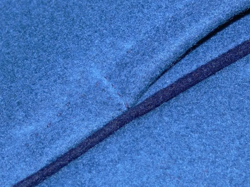

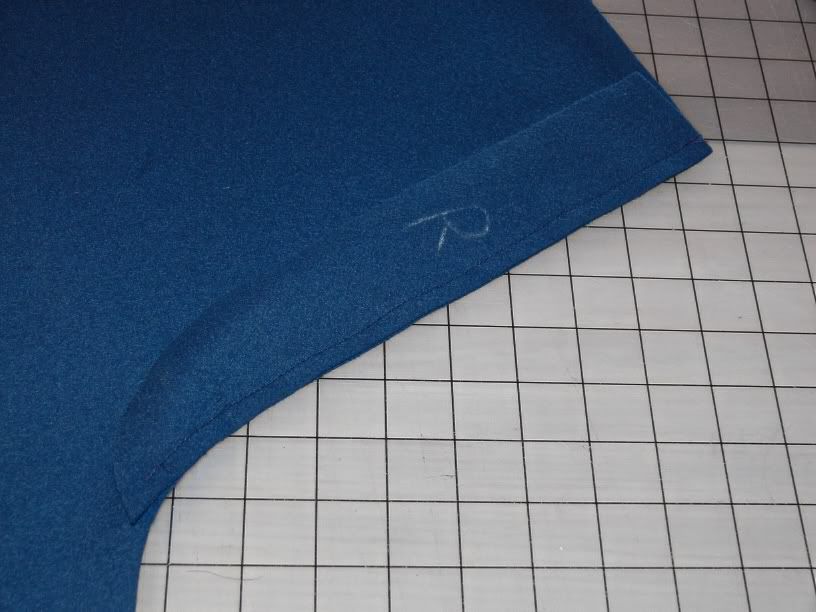

The fronts are now sewn to the backs.  The chalk mark on the right shows where the seam stops, overlapping the pocket facing.  The seam is pressed open.
The fronts are also tacked to the backs above the pocket mouth:

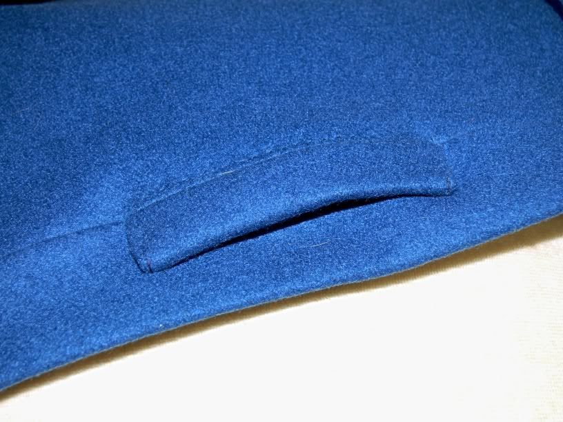

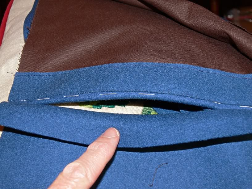

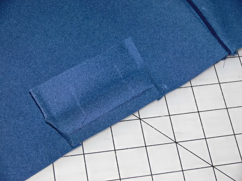

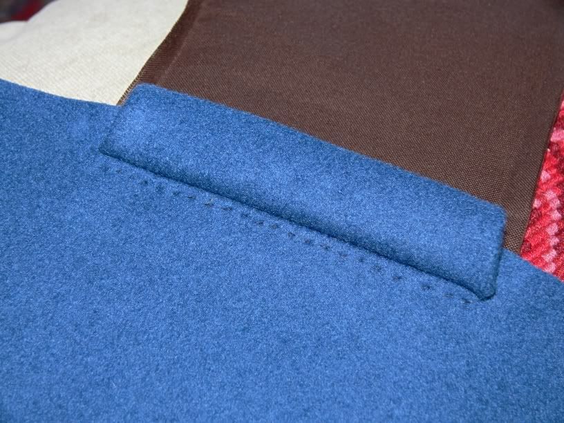

The watch pocket welt piece is sewn to the right front.  The stitching stops 1/4" from the edges so they can be turned in:
The welt after turning in and pressing, but before sewing:

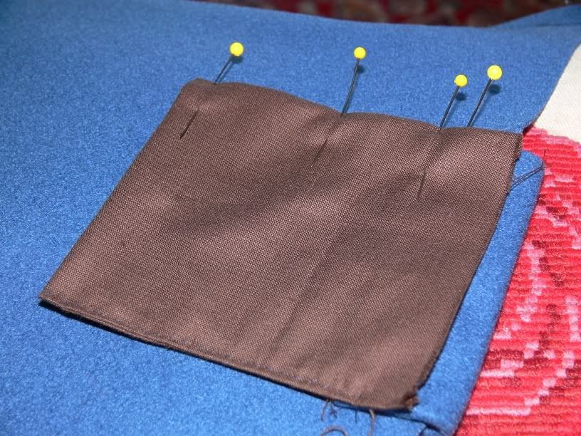

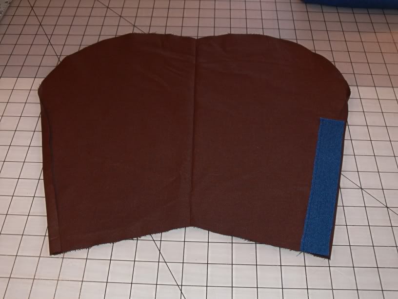

The pocket bag (one-piece) is sewn to the welt:
The welt is folded and stitched into place:
The watch pocket bag is closed:

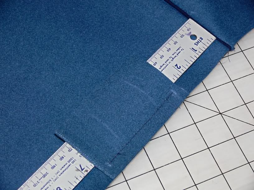

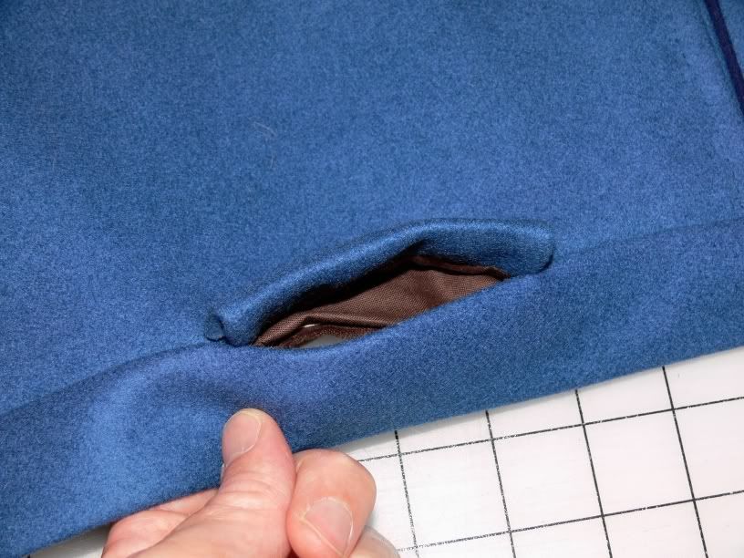

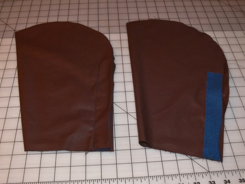

We begin by turning in the seam allowances at the pocket's outer edges, then sewing the outer facing in place so the raw edge is a little bit inside the folded edge.  This edge will be left raw inside the finished pocket.  If using a material that would fray, we would let the facing protrude beyond the edge and catch it in the seam.  The inner facing was already sewn to the trouser back.
Next, the bag is turned wrong side out and the bottom closed up to a couple of inches below the facing.  It's hard to see due to the dark color, but one of the bags here has been turned right side out and pressed.
The bag seam is now topstitched.  The side which will be visible inside the finished trouser should show the "right side" of the backstitch.

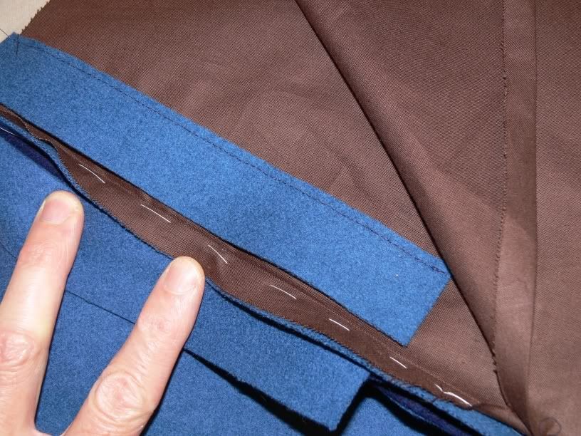

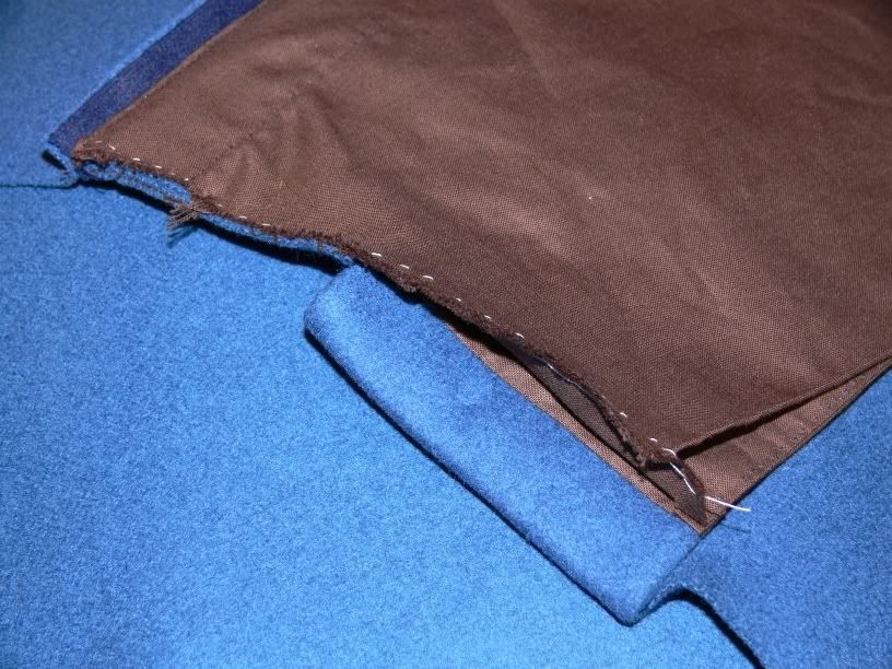

We begin attaching the bag to the trouser by basting it inside the trouser front:
The edges are turned in, and the raw edge outer facing felled down over them:
The pocket mouth is topstitched through all layers, binding the bag in place, and the basting is removed:

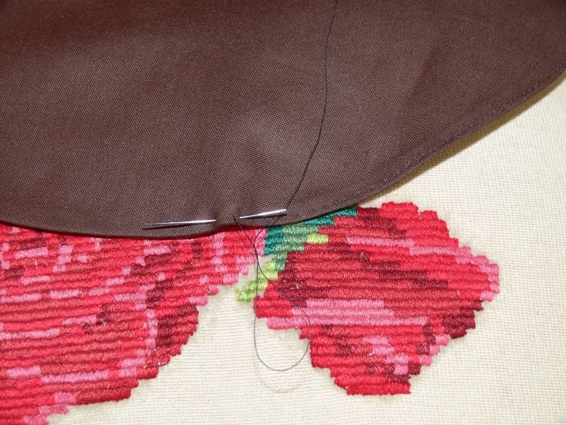

The inside edge of the pocket bag is now sewn to the seam where the inner facing joins the trouser back:

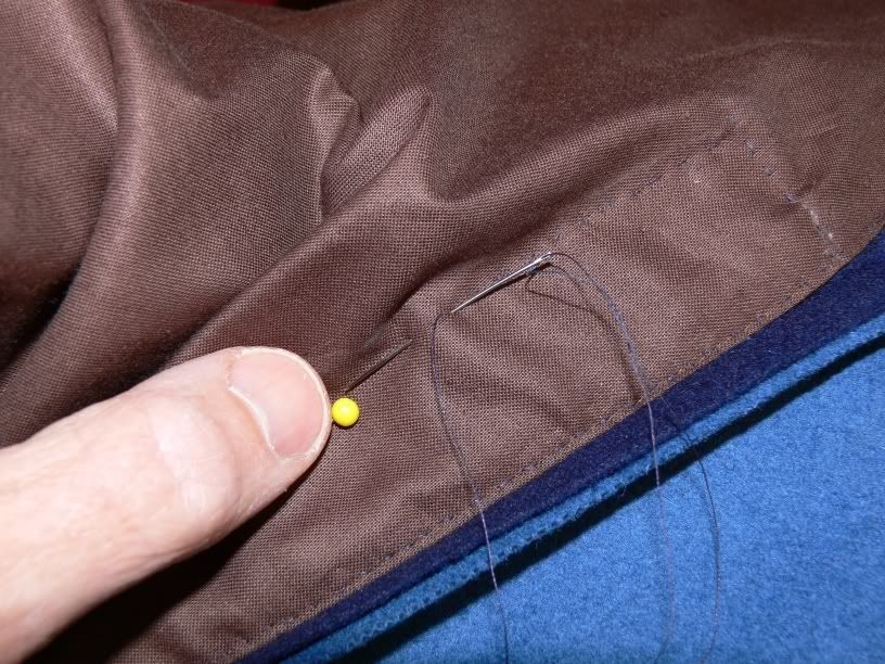

The inner facing is now "caught" by sewing a backstitch blindly through the layers.  Believe it or not, you can feel the edge position pretty well with the fingers and get it where it needs to go.  This trick came from the 1901 "Tailor's Guide".
Finally, the bottom of the pocket mouth is tacked together for strength:

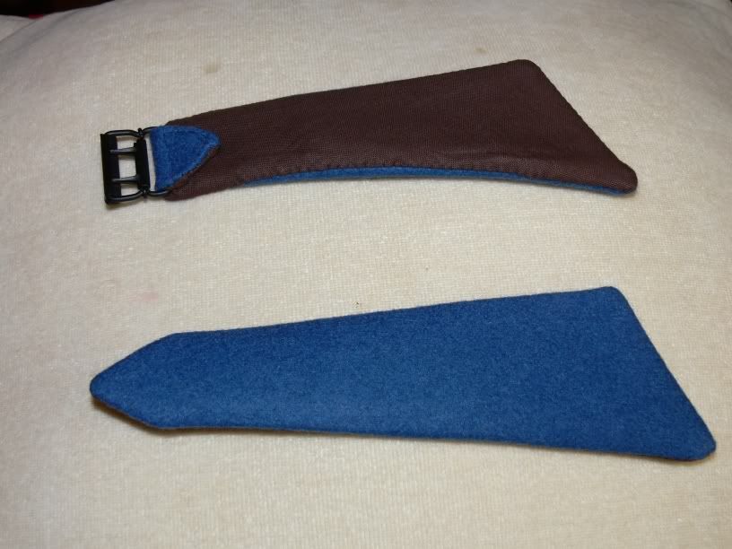

With the pockets complete, it's time to sew on the waistbands.  The left side is shown:
On the right side, the stitching is stopped short on either side of the watch pocket welt as shown:
After pressing the waistband, the welt is pulled through the gap.  It will be sewn down after the waistband is interfaced.

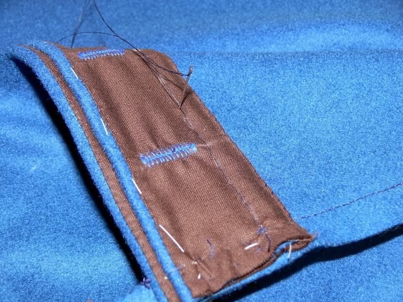

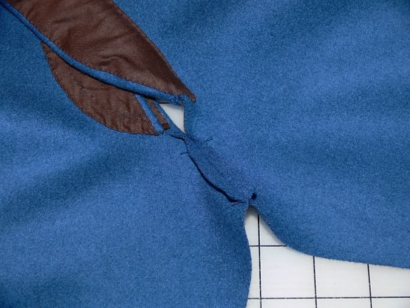

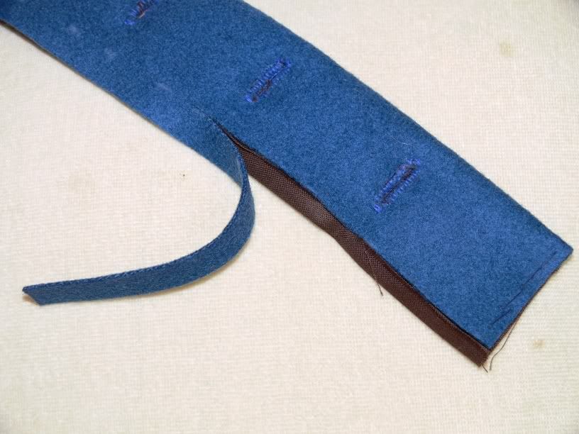

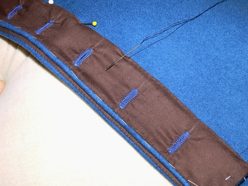

Leaving the waistband for the moment, the fly catch on the right leg is lined as shown.  It's important to fell the lining pieces behind the edge so they won't show when the trousers are worn.
Here's a closeup of the button catch under construction.  The wool and lining are basted together and the lining has been felled:

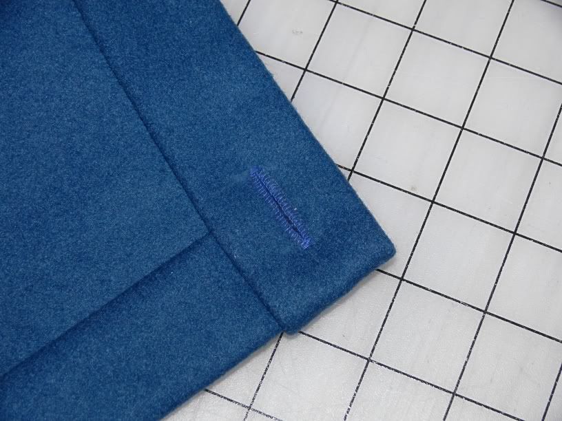

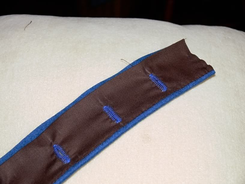

5/8" buttonholes are now made (5 total) to button the fly closed:

Continuing with the flycatch.  Extra material is shaved off to permit the lining to wrap over the edge:
Lining is felled to the front of the left leg in the fly area:
The completed flycatch is basted and pinned into position.  The edge of the lining is felled down:
The flycatch is now secured to the trouser front by topstitching through all layers:

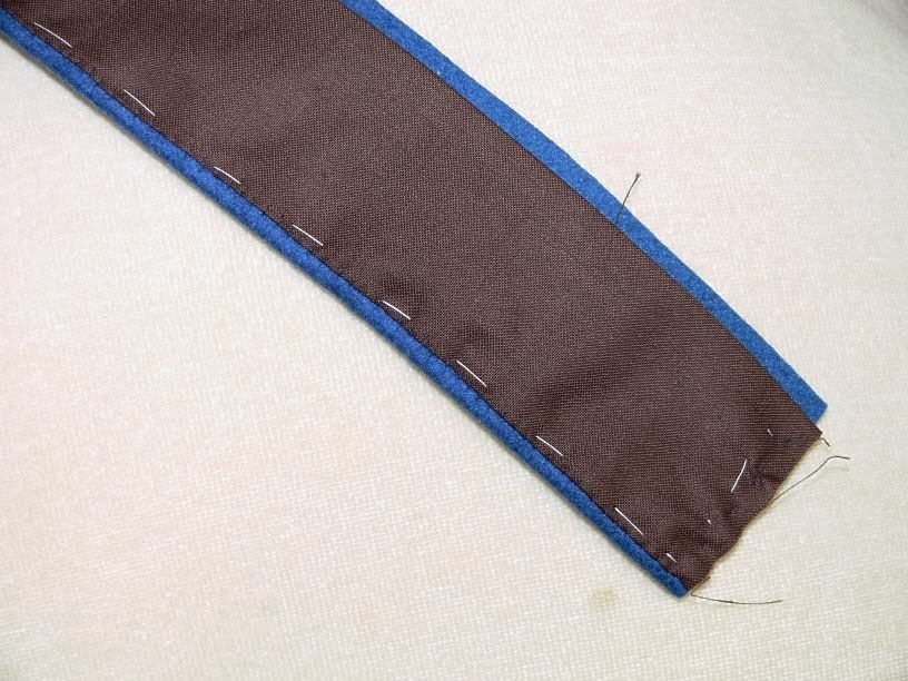

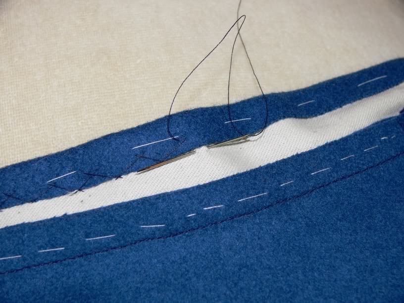

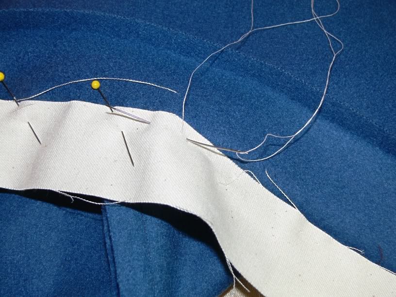

Now it's time to complete the waistbands.  If a flimsy material will be used to line them I like to put in a layer of cotton drill as interfacing.  Here it is being basted to the seam allowance:
The waistband seam allowance is turned over the interlining and secured with a cross stitch:
Buttons may be sewn on at this point so the stitching doesn't penetrate the lining.  The front button is sewn on the inside of the waistband so it will not show on the outside of the finished trouser.  I have a large stock of the white china buttons shown from flea markets.  They are far more durable than the metal or paper-backed tin ones sold by sutlers, and cannot rust out.
Here's the completed left side of the trouser with silesia waistband lining felled on.

We begin joining the legs by sewing the front of the fork together with a 1/4-inch seam:

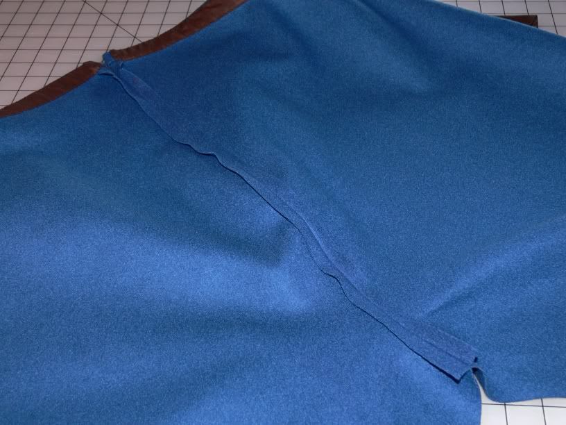

Then the crotch seam is joined from the fork to the bottom of the split below the waistband (I usually leave about 2" at the top for the adjustment belt).  The inseam is joined next, but that's not very photogenic  Smiley.

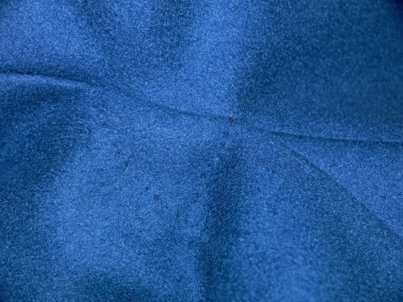

The last short section of the seam below the fly is closed by hand.  Then, the thread is brought through all layers for a few stitches to tack the bottom of the fly opening, and finally the edge of the button catch is whipped down.  Here's the finished result from the inside:
Here's the same area as seen from the outside (top of trousers to the right):

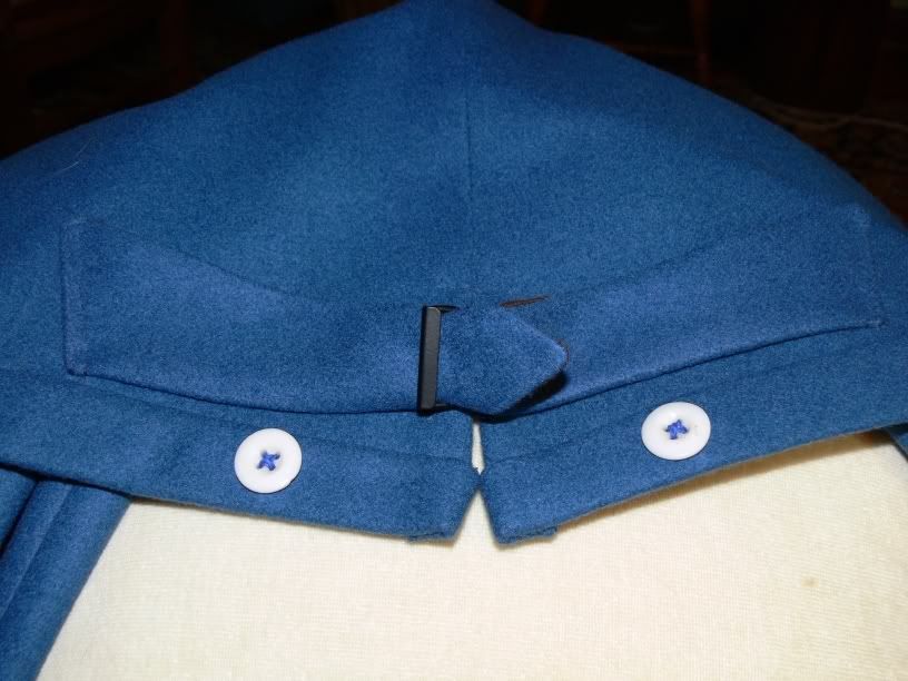

Here are the back belts, which are just seamed around, turned right side out and pressed.  You need to leave a gap in a seam to turn them right side out through.  The left one gets a buckle as shown:
Here they are after sewing in place on the back of the trouser:
