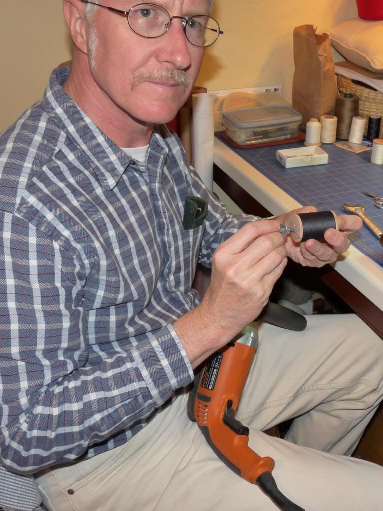

I find modern thread spools distracting when demonstrating period sewing machines "in character", so have been looking for a good way to wind thread on empty wooden ones.  I can find no mention of a period (or modern) spool winding machine available to consumers.  However, I came up with a method that works well for me and might be of use to others.
The first image shows the necessary hardware:
- An electric drill (preferably variable speed)
- A bolt, long enough to go completely through the spool with enough extra length for the chuck to grip.  Nut and washer not shown

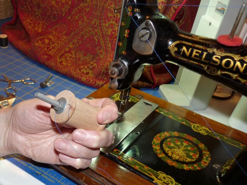

Here the bobbin winder has been threaded, and the free end of the thread trapped between the washer and spool:

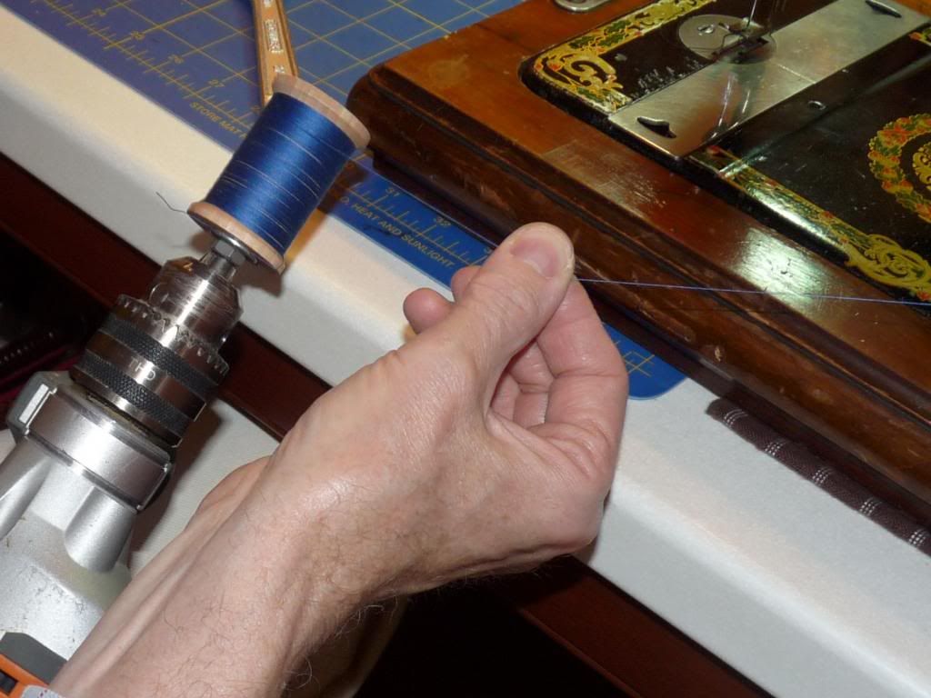

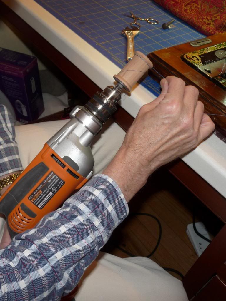

The spool is chucked into the machine, which can be supported in your lap.  Use one hand to operate the switch, and the other to keep the thread feeding smoothly.
Closeup of the free hand and thread.

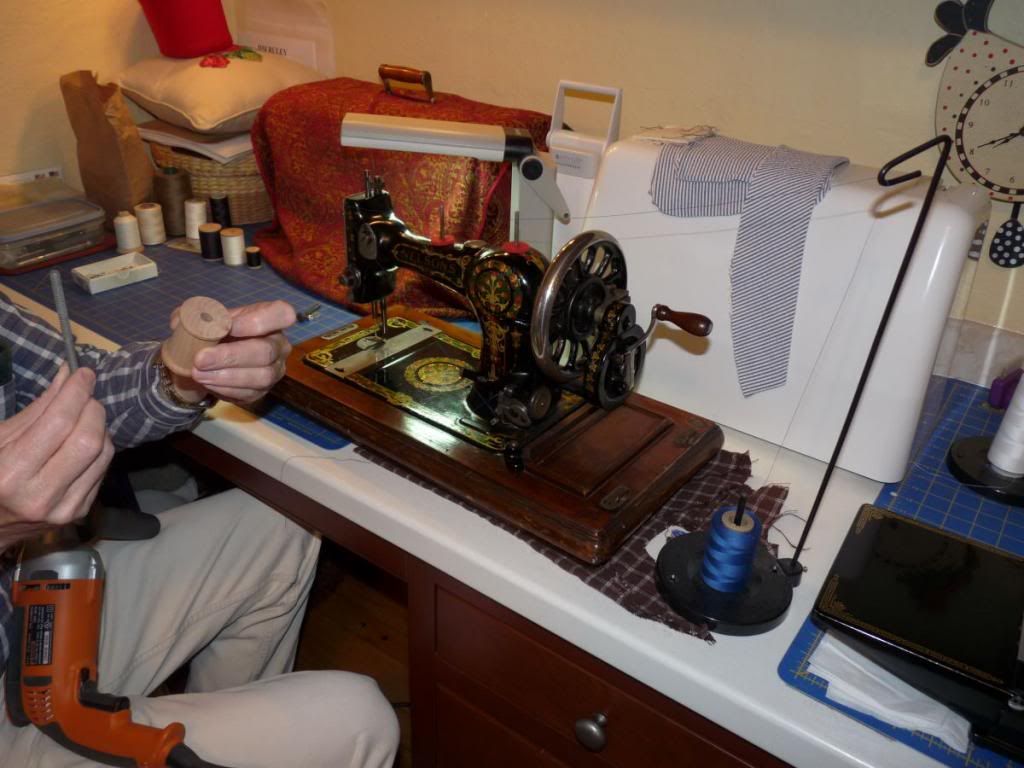

The filled spool after removal from the drill (no, the thread didn't change color, this was actually the previous one)
A small lathe, or even a drill press would probably do just as well.  I'm interested in other people's methods of doing this.
