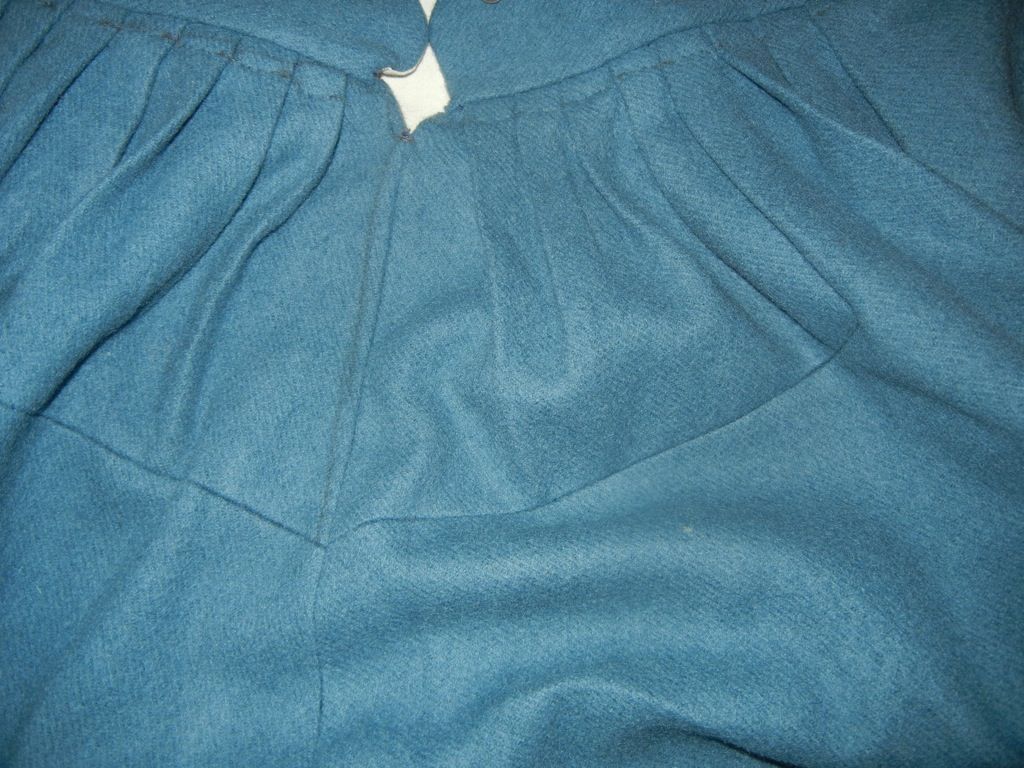

This is the back placket that was giving me so much trouble, as in find/figuring out the size. There is a belt back as well that didn't show in the photo.

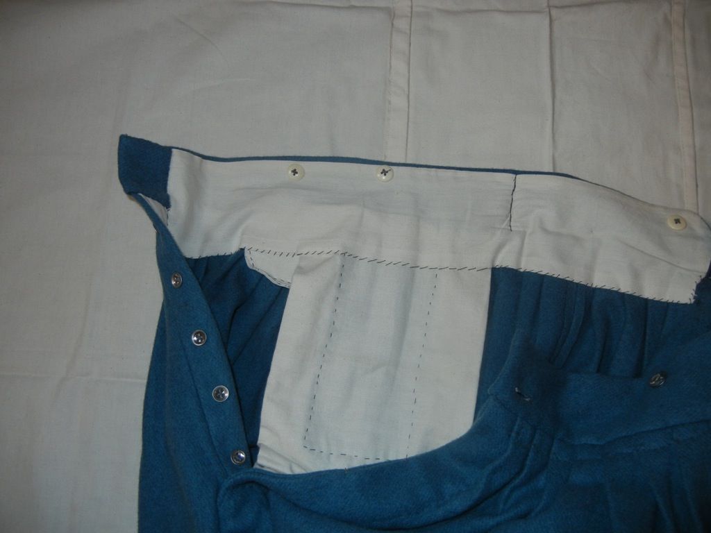

Right interior pocket detail, with watch pocket. The waistband lining on the pair described by CJ Daily in the Gettysburg collection is how I came up with the wide lining.

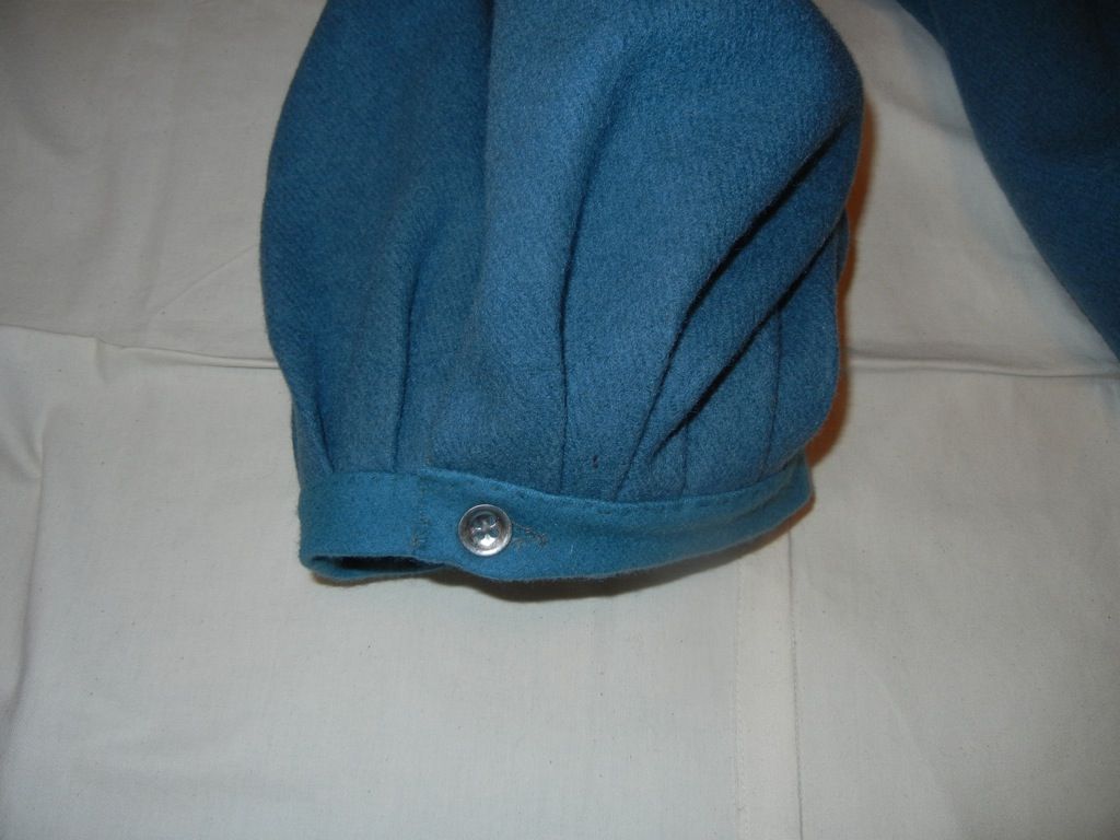

Cuff detail. Trousers are very full in the cuff and I may go back and thin/taper down some. The difference in material is that I ran out of sky blue kersey, Charlie Childs, and ended up using some Wambaugh and White for the band. A friend commented on it but I don't think that anyone would have batted an eye in 1863.
