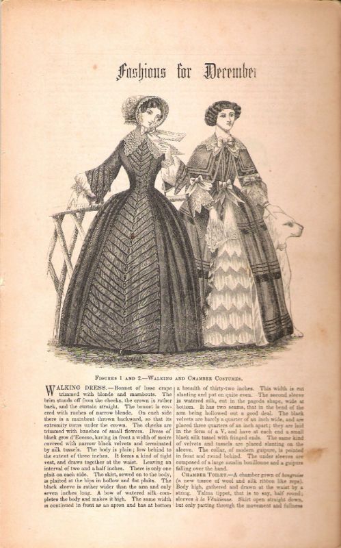

I was looking for costume ideas (1860-1865) and came across this fashion picture.  I don't have the year of it, but the dress on the left is definitely dress-looking.
Posts: 3128
« Reply #17 on: April 05, 2012, 12:04:43 PM »
Kimberly, the print is from the 1850's.  The round shape of the front of the bonnet gives it away.  And there have been a number of wrappers posted in Ebay finds and Museum pics over the years showing wrappers that are definitely dress-like.  Especially the nicer wool & silk ones worn for at-home visits with friends.
