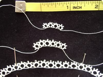

I thought I could add a picture of my thread thickness and lace fineness tests. These little pieces are made with
the same amount of knots in each ring and
they are not starched or ironed. As I live in Sweden I don't have any pennies to show the sizing
with so I hope you can get some idea of the sizes with an inch marked tape.
The top one is Lacis 120, then Lacis 100 and the lowest is the usual DMC cotton size 80.
/Jannike

« Reply #8 on: June 21, 2010, 10:30:14 AM »
Beautiful! Beautiful! Beautiful!  Cheesy
Thank you so much for posting your image. This is so helpful!
