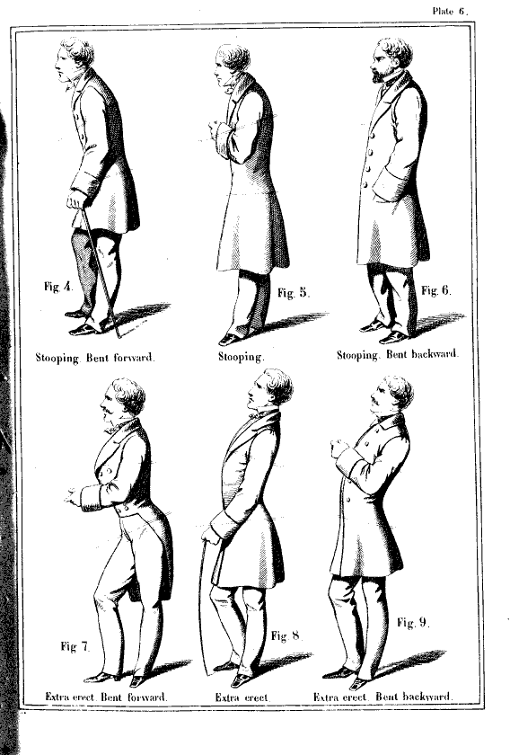

Using these measurements here are the adjustments you need to make.  I'm looking at Plate 6, just after page 20 in the Shep reprint.
Body length:  The proportionate body is 17.25 graduated inches long (18.75 curve measure minus 1.5 inches).  For a 42 chest, this works out to:
17.25*(42/37.5) = 19.32 ("common" or "real" inches)
Your fiance's back is shorter by:
19.32 - 17.5 = 1.82 inches (about 1-7/8).
Look at Fig 3, plate 6, and the alteration will be obvious.
Waist length:  The proportionate man's waist is "3 less than the breast", i.e.
18.75 - 3 = 15.75 (graduated inches)
These are half measures, though, so the proportionate full waist is:
15.75 * 2 = 31.5 (graduated inches)
For a 42 chest, the proportionate waist is:
31.5*(42/37.5) = 35.28 (common inches)
Your fiance's waist is 34, so the difference is:
35.28 - 34 = 1.28 inches (about 1-1/4)
You may want to allow this in the draft as "ease" so the coat won't be too tight at the waist.  If a snug fit is desired, though, divide this into four parts:
1.28/4 = 0.32 (about 5/16)
Look at Fig. 4, plate 6, and take this amount off the front of each forepart and the back of each side body at the waist.
Hope this little exercise not only helps you, but illustrates how graduated and common inches relate.
