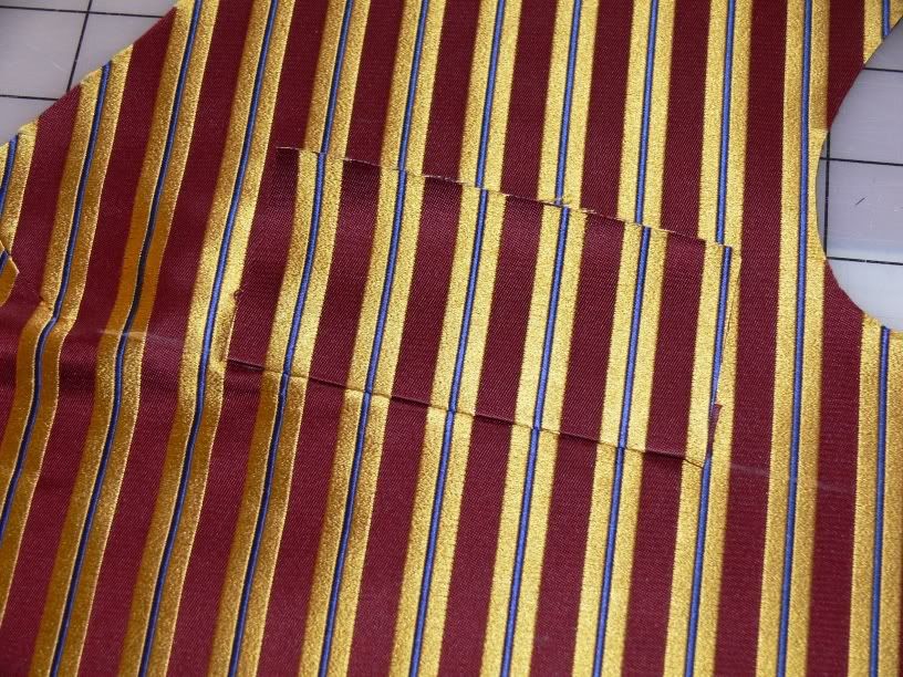

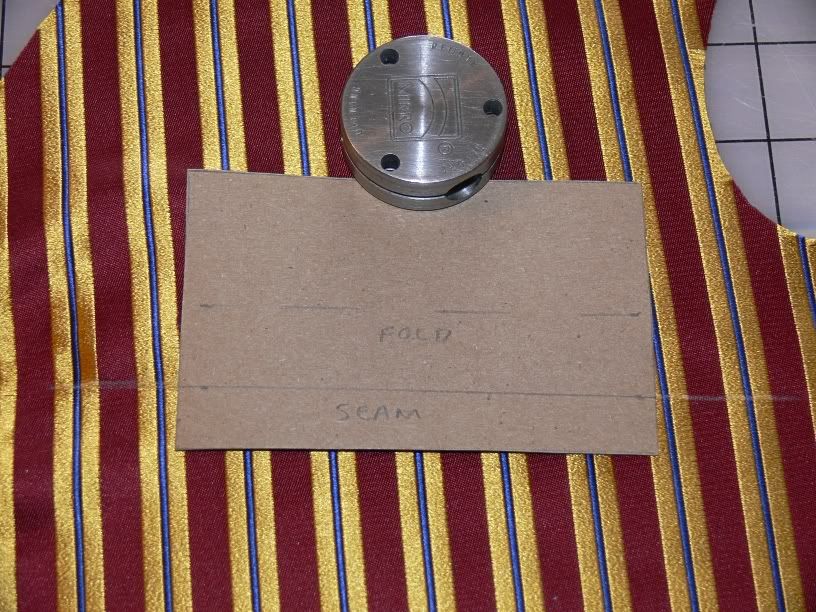

The material is a striped silk, and the welt stripes need to be matched for a good appearance.  A duplicate welt pattern piece is cut out and placed on the front, matching the seam lines:

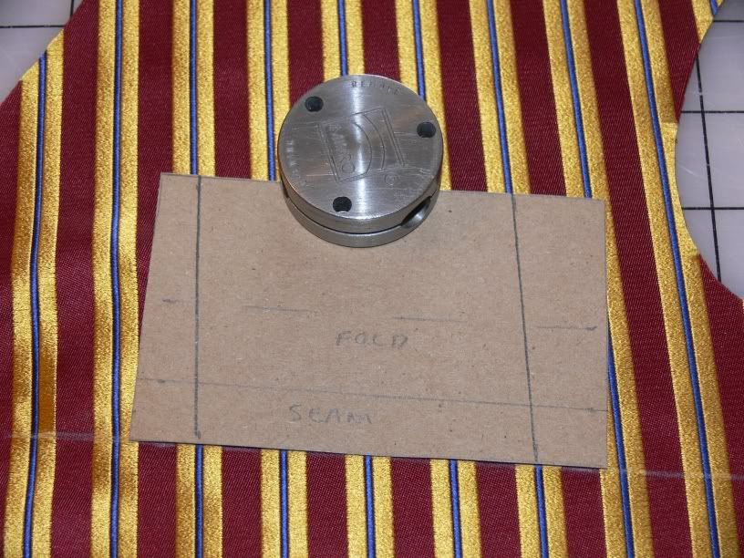

The stripes are now marked on the welt.  (Note:  the seam line should still be matched; I moved it before taking the photo.)

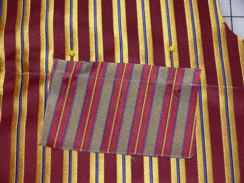

The welt piece is cut out, turned over and pinned on place.  The narrow center stripes make precise alignment easy in this case.
As a final check, the welt is basted on and pressed up.  Voila!  Matching stripes!

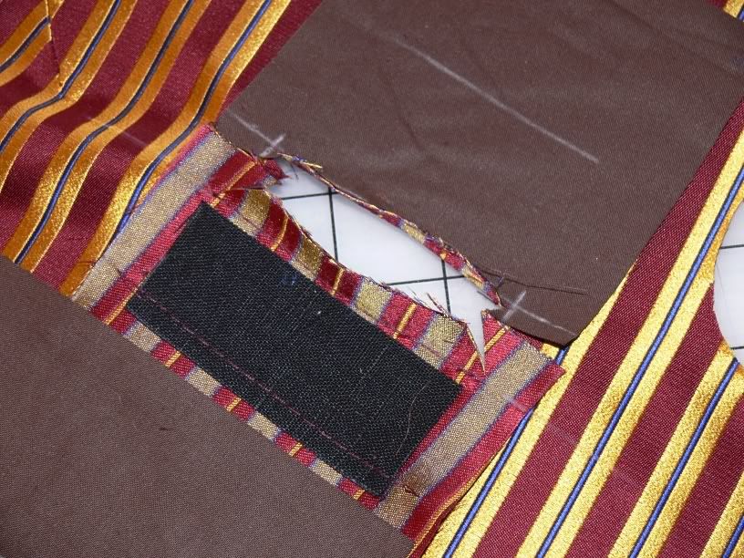

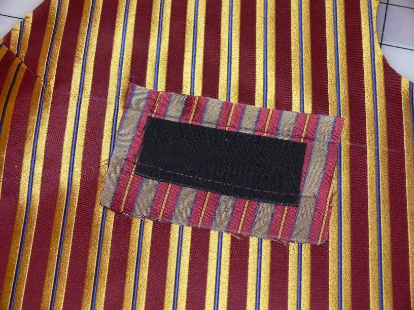

The welt is pressed flat again and sewn strongly to the front.  A linen stay is added, clear of the seam allowances, to bulk out the welt (this is not needed if thicker materials are used).  It will be retained by the topstitching, but is basted for now.
The back half of the pocket bag is placed ready to sew, a little shy of 1/4" from the placement line.  The white chalk lines mark the seam with starting and stopping points.  Notice this seam is a little shorter (1/8" each end) than the welt seam.
After sewing the back bag seam the pocket is slashed open.  The placement line is used as the slit line but not full width.  Clip carefully in a diagonal direction to the four corners.
This picture is of the inside, showing the edges pressed open.  The welt seam is opened and one half pressed down.  The diagonal slashings in the corners are pressed open.

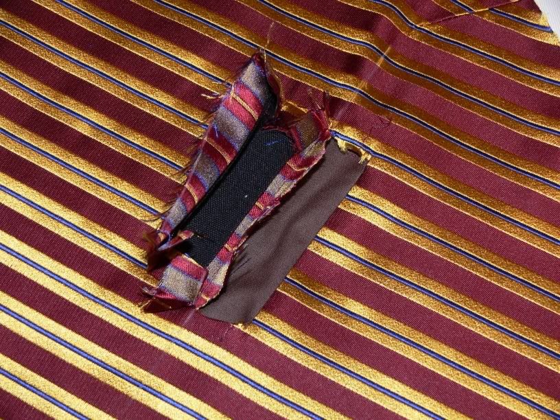

The welt is now tucked through the opening and pressed along the chalk marks.  Ragged edges peeking out of the sides will be dealt with later  Smiley.
The pocket bag is now pressed down, then pulled through the pocket opening (welt partially unfolded for visibility):

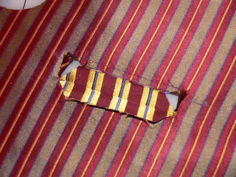

Here the welt has been topstitched, retaining it in position and trapping all the nasty ragged edges.  I used a backstitch top and bottom, and a whipstitch on the sides:
Inside view of the topstitched welt:

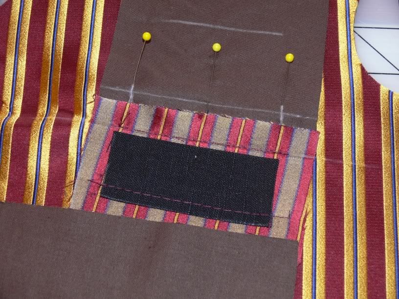

Here the front half of the pocket bag has been pinned to the seam allowance of the welt, ready to sew:
The front bag pressed down over the seam:

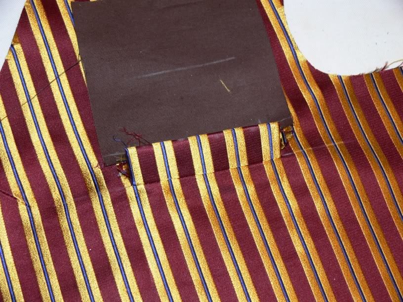

The bottoms of the two bag halves are matched and sewn together.  If the sides are straight it doesn't matter if one half is longer than the other; the bottom crease will be formed by pressing.
Here the bag has been pressed, forming the bottom crease as mentioned previously.  The sides are pinned and ready to sew:
The bag after sewing closed:
The next-to-final (penultimate?) step is to tack the slashings at the sides of the pocket (the material that was folded back at the corners) to the back half of the bag.  This can be done on the back side by pinching the slashing to the bag and backstitching.  Or it can be done from the front with a whipstitch, which helps to retain frayed edges.  Both techniques were used in this case, one on each side.

The picture with the pins, is that where you are sewing on the pocketing that goes in front? By sewing in the ditch? That would also hide the raw edge of the welt piece on the inside.
The interlining for the welt is sewn on different than I thought it would be. I thought it would be sewn into the seam that sews the welt on. But it looks somewhat away from the seam. And looking at the thread showing it sewn to the welt I guess it gets folded over being doubled. Maybe I don't understand what I think I'm seeing?
« Last Edit: February 04, 2008, 02:42:32 PM by J-Waters » Logged
« Reply #11 on: February 04, 2008, 04:10:14 PM »
If you right-click the picture, then left-click on "Properties" you can find the file name.  I assume you are referring to:
If that is the case, yes, except I sewed just above the "ditch".
No, I think you've got it.  I cut the interlining a little smaller than the finished welt size (doubled) so none of the edges would be caught in the seams.  Then I basted it to the welt.  When it's folded over and pressed, it doubles along the top edge of the welt and is caught and retained by the topstitching.  This piece is only necessary if the welt material is flimsy -- most wool vests won't need it.
