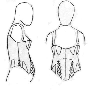

« Reply #8 on: September 12, 2007, 09:08:18 AM »
I have my pattern all made up, based it on last years corset which is based on the simplicity gusseted pattern.
this is an illustration I drew
Now I just need to figgure out the directions my cording should be going.

« Reply #9 on: September 12, 2007, 09:41:27 AM »
Amanda, that looks good.
Vertical cording will stablize the fabric up and down; slanted or horizontal cording can reinforce areas where you want a "shelf"--such as across the bottom of the bust gussets.
Depending on how you tend to carry, a corset that's actually fairly low on the hip/abdomen will help cup and lift the Bump.  I tend to carry Looooooooow, and to get that cupping/lifting, the corset would need to rest in my lap when sitting--cupped under the Bump.  It's not supposed to constrict, though.
