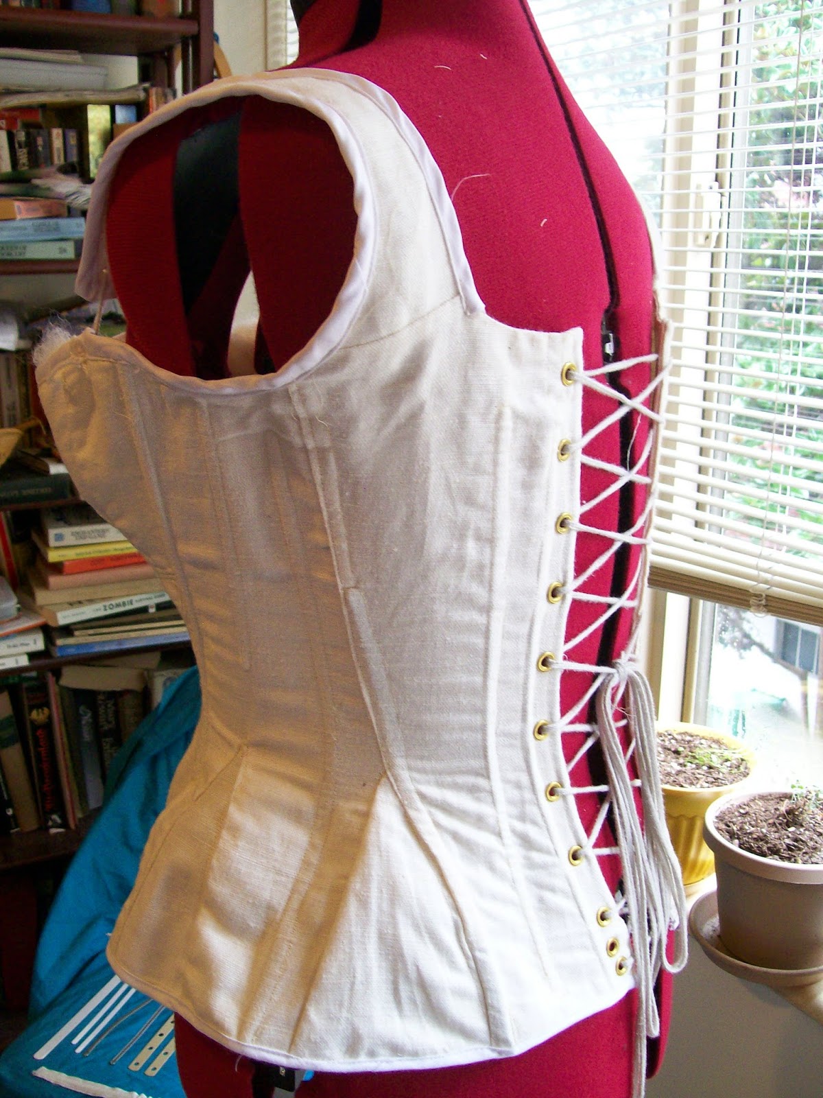

The corded corset I made with straps was 1820s, but in that version, the straps were sewn on to the back panel, and tied to the front of the garments through eyelets.  This made it a lot easier to put on, in my experience, as the straps sat very low over the shoulder.  Adding them also drastically changed the fit, and so I'd do that before making any further changes.
This pic sort of shows how the straps worked on mine:
(Sorry for the huge picture, one day I'll figure out how to re-size them)
For the collapsing bit, my guess is that you need some more cording along the center front and side-front.  Experts?
